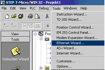

  1. Open STEP 7 Micro/WIN and then start the Ethernet Wizard via "Tools > Ethernet Wizard...".
  Fig. 1: Starting the Ethernet Wizard

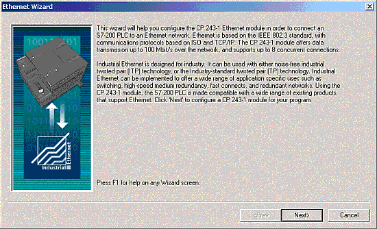

  2. In the first step of the Wizard is a description of the Ethernet Wizard. Click on "Next" to start the configuration process.
  Fig. 2: Description of the Ethernet Wizard

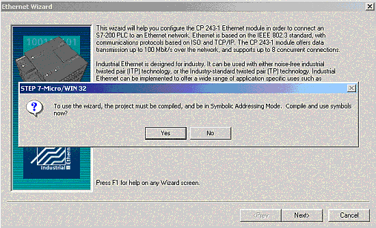

  3. In the window that is displayed you are informed that your STEP 7 Micro/WIN project must be compiled and be in Symbolic Addressing mode. Acknowledge the message with "Yes".
  Fig. 3: Compiling the project and enabling the Symbolic Addressing mode

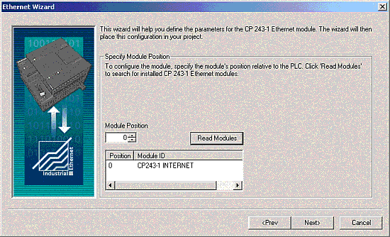

  4. If you are connected with the CP243-1 in your S7-200 station, you can determine the module position of the CP243-1 automatically via the "Read Modules" button. You can also enter the module position manually. Click on "Next".
  Fig. 4: Determining the module position

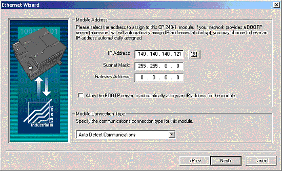

  5. Define a unique IP address for the CP243-1 and specify the associated subnetwork mask. Acknowledge the settings with "Next".
  Fig. 5: Defining the IP address and subnetwork mask for the CP243-1

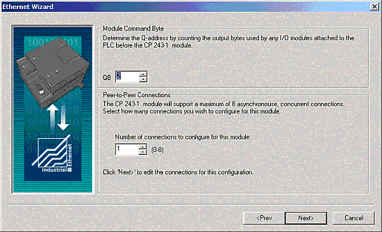

  6. In our example we need an S7 connection for communication to the S7-300. So, for "Number of connections to configure for this module" you enter "1". Click on "Next".
  Fig. 6: Number of S7 connections
